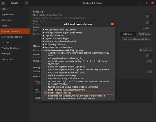

First install gnome-tweak-tool by using this command:
$ sudo apt-get install gnome-tweak-tool
Now open 'Tweaks' application, then go to : Keyboard & Mouse → Keyboard → Additional Layout Options → Miscellaneous compatibility options → check 'Shift cancels Caps Lock'. Close window.
Works fine in Ubuntu 20.04.
'Additional Layout Options' screenshot

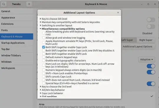

Update for Ubuntu 22.04:
First install gnome-tweaks by using this command (thanks @Paul P)
$ apt-get install gnome-tweaks
Then open "Tweaks", find option within Keyboard & Mouse → Keyboard → Additional Layout Options → Compatibility options → and check 'Both Shift together enable Caps Lock; one Shift key disables it.'.
