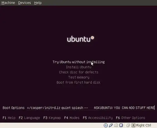

I have the problem in the above answer page and to fix it I need to highlight Live Mode on the CD/USB and press F6 and then type a command. However when I press F6 I get a selection of options.
So how do you input commands on the Live CD mode-selection screen as suggested in the above link.
Press F6, then Escape. It should drop down to something like this:
You can then proceed to add options, as shown on the screenshot. The input will already be focused on that text field. To boot, hit Enter.
