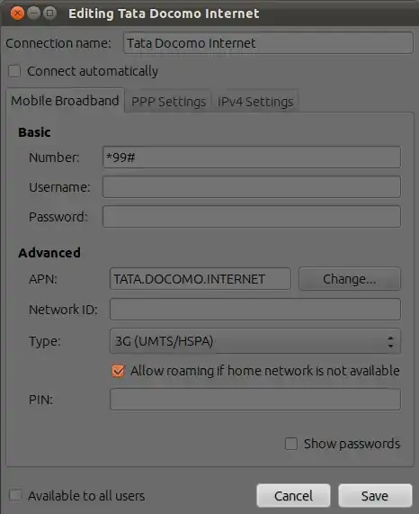

click on network applet > Edit connections.. > Mobile Broadband
select your mobile broadband connection and click Edit
you will see dialog box as below,

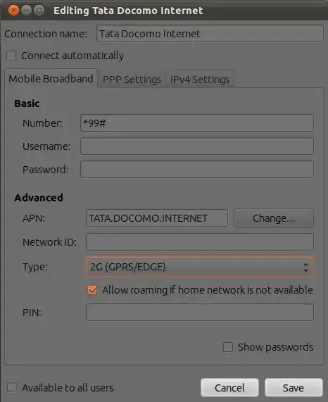

change Type: to 2G (GPRS/EDGE)
click Save. now whenever you try to connect to internet it'll use only EDGE even if 3G network is available.
