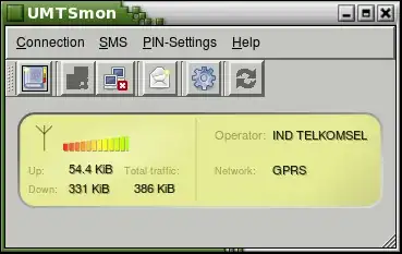

When you connect using ubuntu network manager aplet i think it's automaticaly switch form 3G to Edge eventhough network will be disconnected for a while.
if you want such us standalone network manager like sierra wireless watcher or huawei mobile partner you can use application named UMTSMON, you can monitor the signal, choose the network type, even send sms from this application (if supported)
you can download the source here :
here is the screenshoot :
