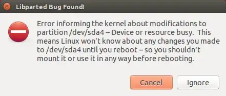

After some partition table problems I finally ran up my Ubuntu and GParted to see my partitions. Then some window appeared.
It sounds really bad...

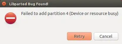

I clicked Cancel and then second one appeared.
I clicked Cancel once again - finally GParted started.

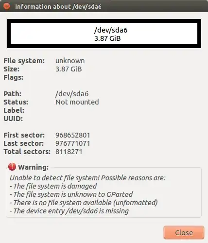

I don't know what to do! GParted says this about my swap:
It sounds bad... At least for me.
/dev/sda4 is my extended partition - this is were my Ubuntu is. Here you can read about my previous problems with partition table. I simply rewrited old partition table - It's not my fault! (I hope)

It is pretty weird but I solved problem (like 75% of it exactly). Here's what I did:
  1. I backuped my partiton table by sudo sfdisk -d /dev/sda > sda-backup.txt
  2. I created file to edit partition table by sudo sfdisk -d /dev/sda > sda-new.txt
  3. I edited my "sda-new.txt" to change partition table and saved it.
  4. I swapped off my /dev/sda6 by swapoff /dev/sda6
  5. I tried writing partition table by sudo sfdisk /dev/sda < sda-new.txt, but I got error bad input or something like that
  6. I decided to restore old partiton table by sudo sfdisk /dev/sda < sda-backup.txt
  7. I opened GParted and I saw my partiions.
I don't know what exactly happened, but I think It works.
