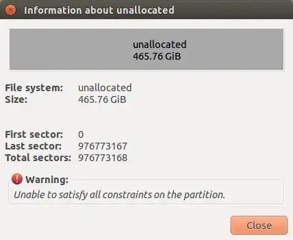

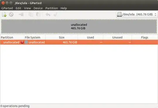

Problem is when I want to add unallocated part of HDD to my Ubuntu partition I can't, because GParted thinks whole disk is unallocated! I tried fixing filesystem by: fsck /dev/sda5 -f -r, but I think that's not it (or I'm doing it wrong way). I have also tried chkdsk from Windows Installation CD, but it didn't fix anything. Also, both of systems are working.
Is it just GParted problem, or maybe HDD is bad for real? If so, how to fix it?

Images: enter image description here This is about partiton
