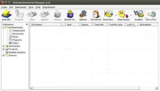

Open the downloaded setup file with "Wine Windows Program Loader" and follow instructions. after installing IDM it will look as shown in screenshot below: enter image description here
Alrighty you have installed IDM but it doesn't look good. does it??. Don't worry we will handle this look thing just after we will be done with Firefox integration Part.

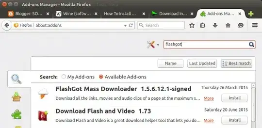

To install Flashgot goto Tools>Add-ons and type flashgot in searchbox and install FlashGot Mass Downloader x.x.x.xx.

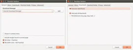

Now goto Extentions and edit flashgot preferences. Under General Tab In Download Manager select "Internet Download Manager" and under Download tab Select "Intercept all Downloads". Click OK.
Congratulations you have completed the IDM installation with full firefox integration.

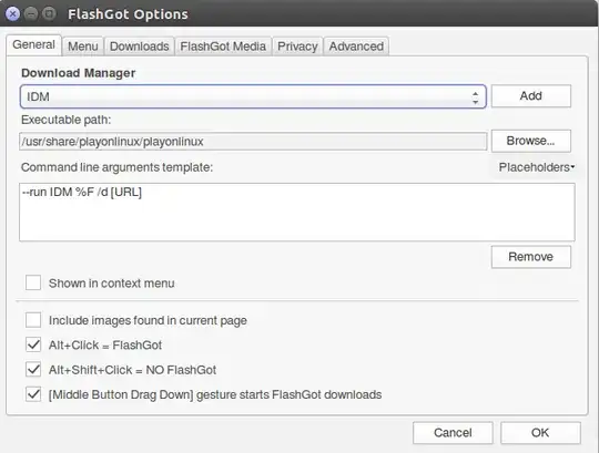

To get Flashgot integration with IDM installed through Playonlinux, following this tutorial:
After installing Flashgot and IDM, closing IDM and, in about:config in Firefox, setting Flashgot.useWine totrue, as indicated in the other answer, open Flashgot settings, and, under General tab, add IDM. For the executable path select /usr/share/playonlinux/playonlinux; under Command line arguments template add the following: --run IDM %F /d [URL].
In the tutorial linked above it says to use --run IDMAN %F /d [URL]. This seems to depend on the version of IDM, as in the tutorial version 5.0.5 is discussed, while I used 6.23. To see what the correct line is, first create a desktop launcher for IDM in Playonlinux (Configure, General tab, select virtual drive, Make a new shortcut...), open that launcher in a text editor ans see what the Exec line says (in my case it was --run "IDM" %F). Select IDM under the Flashgot tab, restart the browser and it should work.
