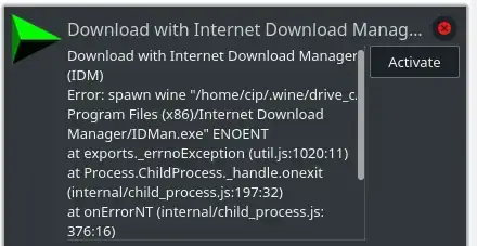

I want to use Internet Download Manager for downloading on Firefox. According to this answer it can be done with the extension called Flashgot. But Flashgot does not work on new Firefox Quantum. However, I found this extension that can be used to interrupt browser's downloading jobs by redirecting these jobs to an external download manager like Internet Download Manager (IDM). But I don't know how to integrate IDM with this new extension. I wrote IDM's location (/.wine/drive_c/Program Files (x86)/Internet Download Manager/IDMan.exe) in the box that says "Path to the executable" but when I try to download something, an error is appearing.
The preference page of the extension
the extension's settings page
The error that is appearing while trying to download files
the error
How can I make it work? Thanks beforehand!

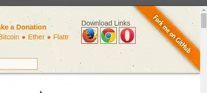

The extension you mentioned is available at that address through these buttons/links:
But, as this is about Firefox, the link for the Firefox version is NOT available: see here; neither is the one for Chrome (here), while the one for Opera can be installed, but I suspect it is made to work with a Windows installation. It might be directed to Wine/Playonlinux, and in Opera I can see what you are asking. You should post a question on Opera.

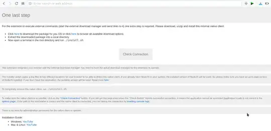

I was redirected to a page within the extension (not a url that I could post here) saying that (just like for uGet - see the second part of this answer) we need a separate client. This is the page:
See if you can access it here (although that might only work in Opera): chrome-extension://kajaikkhnmegmfnlifeklklaienhdekb/data/guide/index.html#
The links in that page are:
The idea is to unpack the archive for Linux and execute the .install.sh file. But even after that I get an error:
That is:
Download with Internet Download Manager (IDM)
Error: spawn /usr/share/playonlinux/playonlinux --run IDM %F /d ENOENT
at exports._errnoException (util.js:1020:11)
at Process.ChildProcess._handle.onexit (internal/child_process.js:197:32)
at onErrorNT (internal/child_process.js:376:16)
at _combinedTickCallback (internal/process/next_tick.js:80:11)
at process._tickCallback (internal/process/next_tick.js:104:9)
The same happened when installing IDM in Playonlinux.

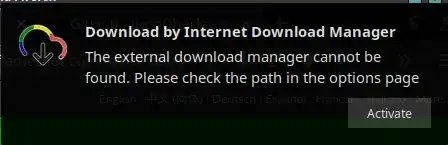

The IDM extension for Firefox is in fact here. It needs the installation of a second tool - shown when trying to download.
It shows on right-click on download link.
After adding the link to the executable (of playonlinux or wine) within the addon preferences it shows this though:

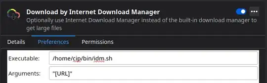

The only progress I made was using a script idm.sh:
#!/bin/bash
/usr/share/playonlinux/playonlinux --run "IDMan"
and the path to that in the extension preferences
In this way IDM at least starts on right-click, and we can confirm that the extension is working — also, adding uGet instead of IDM, uGet works (just like with the uGet extension) — unlike many other on the Firefox addon site that claim to open online videos in MPV, etc. By the way, this one works with MPV for now, )

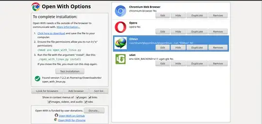

Another good addon that has resurfaced in Quantum is OpenWith. Made for Internet browsers, it can also launch players and downloaders. But with that too, IDM just opens.
play
