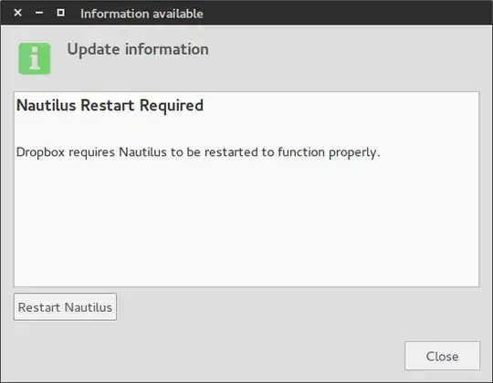

Every time I log in Dropbox opens up the screen informing me that Nautilus needs to be restarted.
Dropbox "Nautilus Restart Requried"
Clicking the restart button does nothing though.

Try
sudo nautilus -q
or install a newer Nautilus for 14.04/13.10 from here
EDIT: What I forgot, after installing Nautilus 3.12, you will have to reboot -> sudo reboot
Report back if it worked ;)

I hope your problem has been resolved, if not this may help. I was also facing the same problem and this helped me.
Download the .deb file of Dropbox from here on the dropbox.com site.
Then after download, right click and select Open with software install.
Then install it.
software center
Start drop box and you will get little dropbox icon on top right.

I had this problem after having installed Ubuntu 16.04 und Dropbox, nothing else. I have no idea which Nautilus comes with Ubuntu, but as it is the newest Ubuntu, I assume, it's also the newest Nautilus. So I did not do any update on Nautilus, but only ran
sudo reboot.
After a PC Restart the Nautilus Restart Required window showed up again, but now I was able to close it from the Close button. From then on, the window never showed up again.
