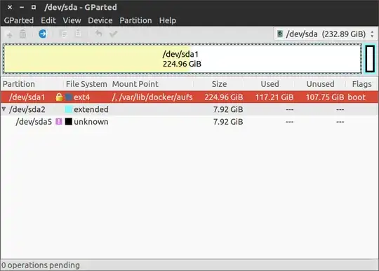

sudo lsblk -o NAME,FSTYPE,UUID
NAME   FSTYPE UUID
sda
├─sda1 ext4   3dbb0bca-df4c-426d-a672-2e31e6683646
└─sda5
GParted: enter image description here
Any help is appreciated =)

It looks like the UUID for your swap partition isn't being reported. I don't know if that's supposed to be normal for encrypted swap, but you could try specifying the partition using other methods in crypttab, such as:
cryptswap1 /dev/sda5 /dev/urandom swap,cipher=aes-cbc-essiv:sha256
