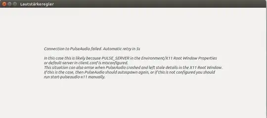

The pulseaudio volume application displays:

I had the same issue. I was able to fix it using the following steps:
  1. Removed ~/.config/pulse directory.
  2. Started Pulse Audio.
    rm -rf ~/.config/pulse
    pulseaudio --start
Incase if its still showing errors you will have to reinstall pulse audio and equalizer.
sudo apt-get purge pulseaudio pulseaudio-equalizer
sudo apt-get install pulseaudio
sudo apt-get install pulseaudio-equalizer
pulseaudio --start
