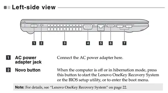

According to the manual on page 7 (actually 13 in the document):
  1. Shut down the computer.
  2. Press the Novo button and then select BIOS Setup.
On this model it is a small button near the power connector:
