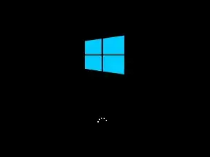

A source of confusion may be branding, because computers that come with UEFI and a preinstalled copy of Windows 8 have a consistent branding during boot, which means that these machines just display one high-resolution splash image, where there would have previously been several pixelated or blurry images until the Windows boot splash appeared.
Manufacturers today use branding to blend in the device pre-boot sequence with the Windows 8 boot process. Correct, the memorable boot splash has been mostly replaced by branding, but you can still identify that the Windows 8 boot process has taken over when the spinning dots appear:
Windows 8 spinning dots, like shown during boot phase

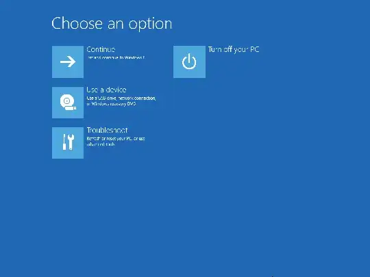

From within Windows 8
It's possible from within Windows 8/8.1, have a look at the Windows Startup Settings article on the Windows site for more details.
  • In Windows 8 go to:
    • General > Advanced startup
  • In Windows 8.1 go to:
    • PC settings > Update & Recovery > Recovery > Advanced startup
  • Which will take you to a blue screen... with options to choose from.
    • Choose an option > Troubleshoot > Advanced Options > UEFI Firmware Settings
    blue screen without death, but recovery and advanced boot options
