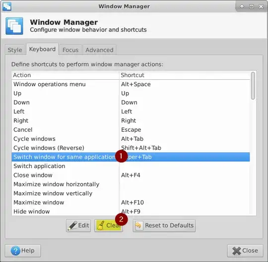

If your case is terminal tab not working under Xfce, the solution is as follows:
  1. Open Application Menu > Settings > Window Manager.
  2. Click on 'Keyboard' tab.
  3. Clear the 'Switch window for same application' setting.
Window Manager screenshot how to clear switch window for same application
I've found the solution here.
