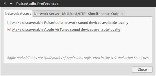

I've enabled "Make discoverable Airplay AirTunes" sound devices locally. I've tried deleting the pulseaudio preference files I can find and uninstalling/reinstalling pulseaudio; airplay still doesn't work. I even upgraded to the in-development pulseaudio 5.0 - same results. Pulse seems to work fine except it doesn't "see" my Airplay devices.

Run paprefs and check the option to make AirTunes devices available.paprefs dialog
