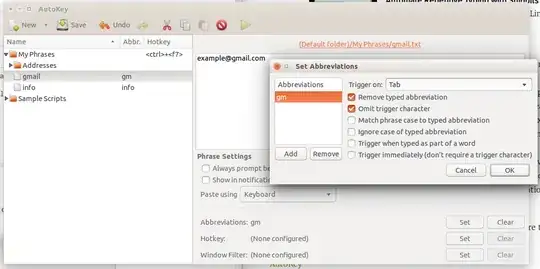

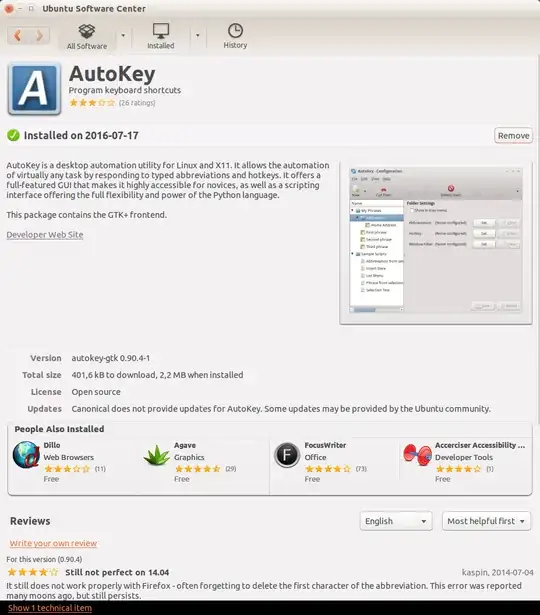

I use AutoKey it installs from the Ubuntu Software Center
real easy to use
I have added "phrase"s like my email address example@gmail.com by typing gm plus hitting tab <tab>

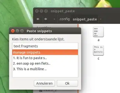

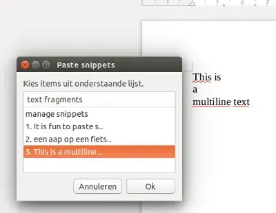

When the script is called, a window appears, listing snippets you defined. Choose an item (or type its number) and the text fragment will be pasted in the frontmost window of any application that is Ctrl+V "-compatible":
Adding / editing snippets
When you choose manage snippets, the script's folder in ~/.config/snippet_paste opens up in nautilus. To create a new snippet, simply create a text file with your snippet's text. Don't mind the name you give the file; as long as it is plain text, it is ok. The script only uses the file's content and creates a numbered list of all the files ('content) it finds.
