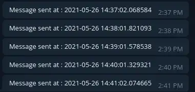

And this is what I received in the bot as expected:
