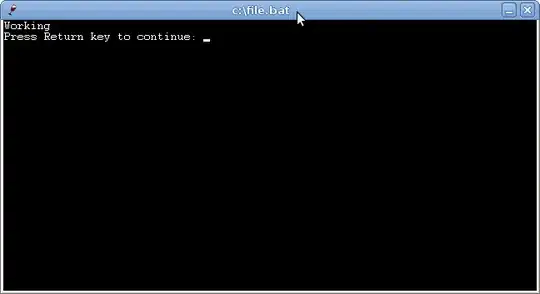

You can run DOS batch file through wineconsole:
$ cat ~/.wine/drive_c/file.bat
@echo off
echo Working
pause
$ wineconsole 'C:\file.bat'
You get a new windows similar to this

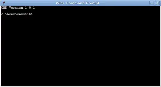

Also, you can enter an interactive DOS prompt with
wineconsole cmd
You will get:
