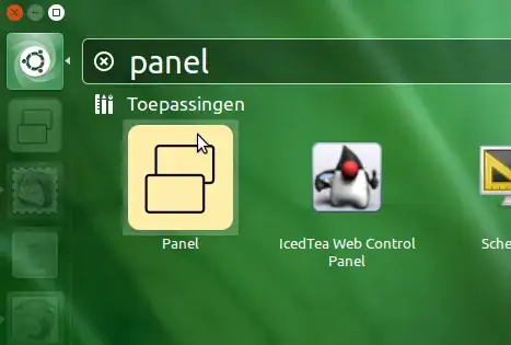

The problem is that you cannot "run" a .desktop file from Dash with arguments, so the setup exactly like you have in mind is impossible I am afraid. However, assuming your script does take arguments, there are a few elegant alternative options, maybe even better:

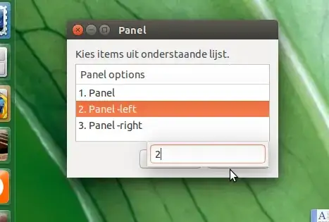

  1. Not the most obvious one, but exploring the options, it should be mentioned: you can call a (zenity) option list from Dash:
    Type the first character of your option, press return and your script will run with the chosen argument.
    Again assuming that you saved the script in ~/bin, made it executable and removed the language extension as in 1.:
    • Copy the script below into an empty file, save it as panel_options.sh, make it executable.
      #!/bin/bash
      test=$(zenity --list "1. Panel" "2. Panel -left" "3. Panel -right" --column="Panel options" --title="Panel")
      if [[ "$test" = "1. Panel"* ]]; then
          <scriptname> <default_argument>
      elif [[ "$test" = "2. Panel -left"* ]]; then
          <scriptname> <argument_1>
      elif [[ "$test" = "3. Panel -right"* ]]; then
          <scriptname> <argument_2>
      fi
    • Create the .desktop file from the code below. In the Icon= line, set the path to your icon, in the Exec= line the path to pane_options.sh, save it as panel.desktop in ~/.local/share/applicatios
