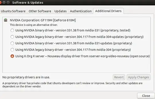

I'm using Ubuntu 14.04,64 bit, with nvidia 610M dedicated graphics card.
By default when I go to "Softwares & Updates" > "Additional Drivers" it shows "Using X.Org X server-Nouveau display driver..." selected.
But I wanted to switch to proprietary nvidia driver so I selected "Using NVIDIA binary driver-version 331.38..." and clicked "Apply Changes" but shows a progress bar and after few seconds the "Nouveau" driver again shows selected.
I gave apt-get update from the terminal. Did a reboot after "Apply Changes" But still no luck.
It shows Nouveau driver ever after "Apply changes" and Reboot

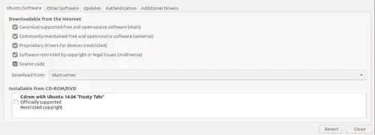

Under "Ubuntu Software" in the Software & Updates page set the Download From to be "Main Server"
This then lets you install the drivers...
You can then Install the Drivers for the Nvidia
