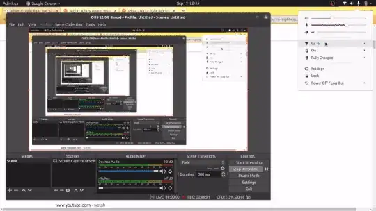

Today I realized that Night Light stopped working in my machine. When I try to set it up, nothing happens. See attached gif:
trying to enable night light
I am not sure what's causing it to fail. I don't know if there are any logs generated by this tool, or if there's another way to enable Night Light.
Any idea what to try? This was working a few months ago.

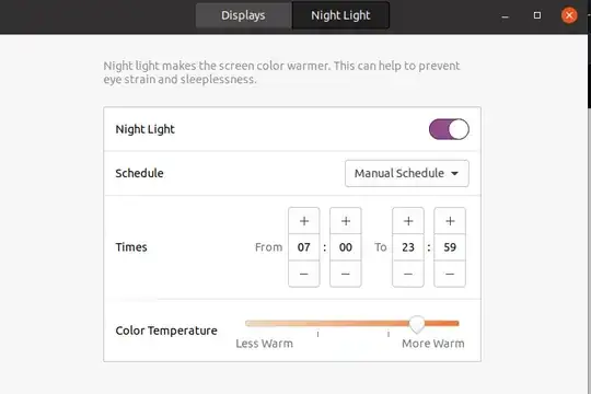

Flux was conflicting with the night light program, enabling the Manual mode worked for me.
