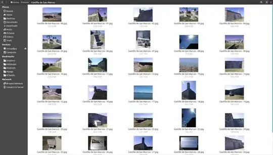

After a single change, the above folder now looks like this when set to 200% icon zoom level:
200% fixed

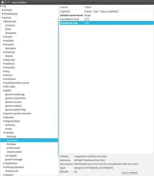

Once you have "dconf-editor" open, navigate to the following location in the left pane:
org > gnome > nautilus > icon-view
See this example image for the location:
dconf-editor
The value that needs changed is the "thumbnail-size" value. I changed it from a default of 64 to 128. Depending on your display resolution, you may need to change it to a different value to make things look exactly the way you want. Smaller displays might need a value larger than 64, but 128 might be to large, so try something like 96.
