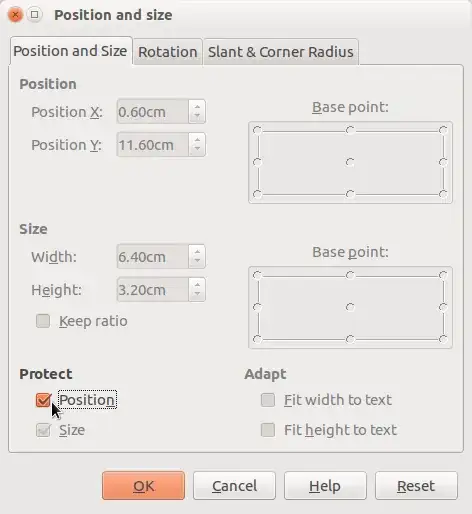

You can protect an object position (i.e. your reference object).
Right click on the reference object, select Pozition and Size…. Check Position option under "protect" (see the screenshot below); then do the alignment.
Protect object position
PS: It seems LibreOffice takes the relative center of the whole two objects, i.e. the centerline of a surface covering two objects, and then move all of them so that their centers sit on that centerline.
