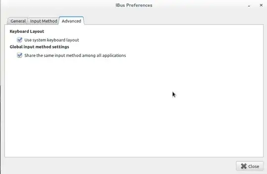

Quoting the proposed workaround, from Martin JurĨa:
  1. open terminal
  2. run ibus-setup
  3. open the Advanced settings (the last tab)
  4. check the "use system keyboard layout" checkbox
Example of ibus-setup setting
