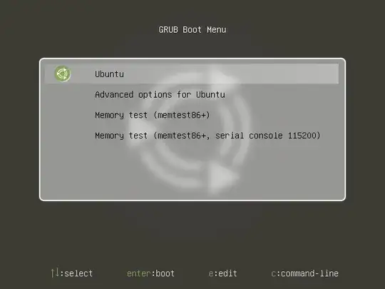

  1. Hold down Shift while booting to get a GRUB menu.
    It should very generally resemble this screenshot, but may be expected to look different depending on which Ubuntu flavor and release you're running.
  2. "Ubuntu" is selected by default. Keep that selection, but press e to edit it.

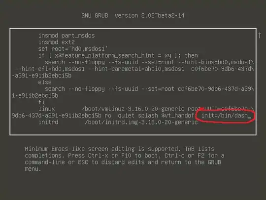

  3. Move to the end of the line that beginning linux /boot/vmlinuz-.... (You can use the arrow keys, and End to get to the end of the line.)
    Type a space, then init=/bin/dash. Then press F10 to boot this configuration.
    Source: How to set NOMODESET and other kernel boot options in grub2

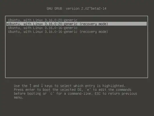

  1. To enter recovery mode, hold down Shift during boot to get a GRUB menu.
  2. Select Advanced options for Ubuntu.
  3. In the menu of available kernels, press to move the selection to an entry ending in (recovery mode), and press Enter.

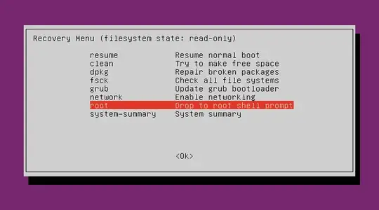

  5. In the Recovery Menu, press repeatedly until
    root              Drop to root shell prompt
    is selected. Press Enter.
  6. Perform steps 5 and 6 (and optional step 7, if you like) from the init=/bin/dash Should Work method above.
