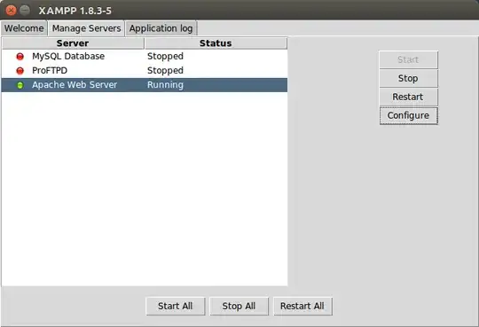

I am having trouble finding out how to start the expanded GUI. I have found a tutorial on how to start this one sudo /opt/lampp/share/xampp-control-panel/xampp-control-panel
mini xampp gui
But I am not able to find out how to start this one maxed xampp gui

You can use the command below
if you use 32 system :
sudo /opt/lampp/manager-linux.run
if you use 64 system :
sudo /opt/lampp/manager-linux-x64.run

The fastest way to spit out the GUI is to use the following codes. One after the other.
cd /opt/lampp
sudo ./manager-linux.run (or manager-linux-x64.run)
Snapshot of the terminal
