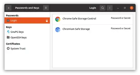

I then also observe that under "Passwords and Keys", which is the:
seahorse
GUI frontend for GNOME key ring, that there is a Chromium entry:
which is presumably contains the key to decrypt the passwords in the database.
That GUI also showed all my old passwords left over from previous Chromium versions, which I now nuked (and then had to reset the password database because I also nuked the Chromium key by mistake, but Google autosync saved me :-) https://superuser.com/questions/573602/chrome-not-saving-passwords-and-not-auto-filling-existing-login-passwords/1325741#1325741 )
This gets automatically unlocked at login time.
