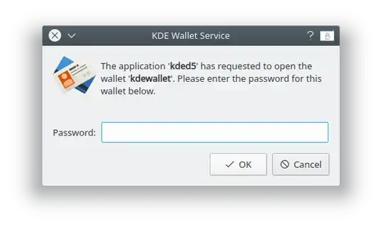

On my Ubuntu 18.04 Bionic Beaver LTS, the following popup appears often when working with Docker and I'm not purposely doing anything that would require a password:
KDE Wallet Service: The application 'kded5' has requested to open the wallet 'kdewallet'. Please enter the password for this wallet below.
The kded5 man page doesn't help me understand what's going on, and I'm not using KDE Wallet, so I always click Cancel, and soon it appears again.
Tried to untick Enable the KDE wallet subsystem via Start->KDE Wallet but this caused my Chromium to "forget" all saved passwords, so it's ticked again, and Chromium "recalled" the saved passwords again - so it turns out I am using KDE Wallet after all.
Tried to untick System Settings->Notifications->(drop down)->Wallet->Needs password->Show a message in a popup, but still it appears.
Q: How to get rid of it without making Chromium unusable, and what is going on? Would be grateful for any hint or link to good documentation. I'm ok if Chromium can be configured to store passwords elsewhere.

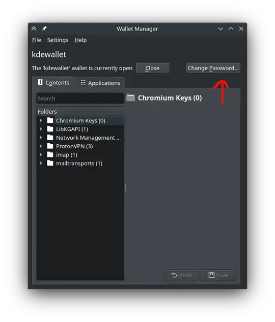

I also faced this problem. For me, it was because I had just changed my user password (same as admin) and kwallet which I guess stores all the passwords (e.g. Wi-Fi password) wasn't aware of the new password. Because of this, I had to enter my Wi-Fi password every time I logged into the system.
To change the password of kwallet, click on this button inside KWalletManager... KWalletManager
Just entering the old password (or new, after changing) into the prompt from kwallet [kded5] fixed the issue for me.
