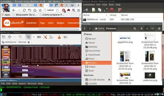

A screenshot from my current desktop is placed here for you to see i3WM in action.
On this screenshot you can see Nautilus File Browser floating and the other windows are tiling.
