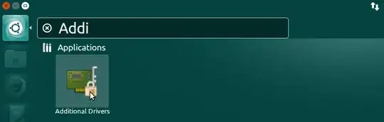

Open the "Additional Driver" dialog:
Or from a terminal software-properties-gtk --open-tab=4
You will get some suggestions for your video card.
