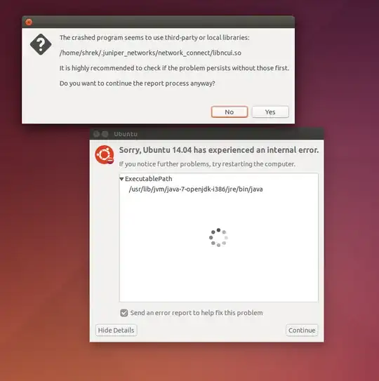

I saw this post, but unfortunately continue to have issues as seen here: https://i.sstatic.net/4KctR.png
Does anyone have suggestions for fixing this issue?
