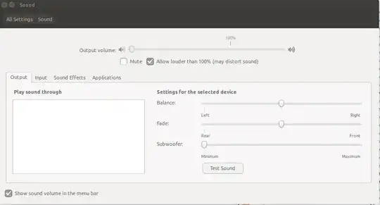

The Sound Settings (unity-control-center sound) does not show any devices.
Sound Settings

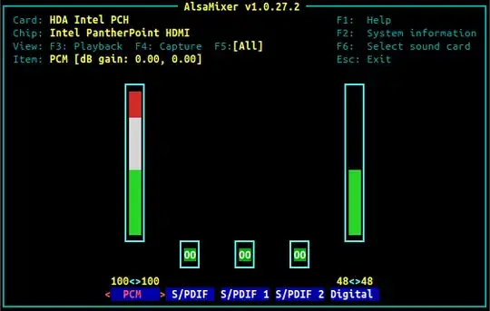

AlsaMixer, after F5 (show all) has 2 channels I can change PCM and Digital, I swear there used to also be a master channel (and maybe others) before.
AlsaMixer
