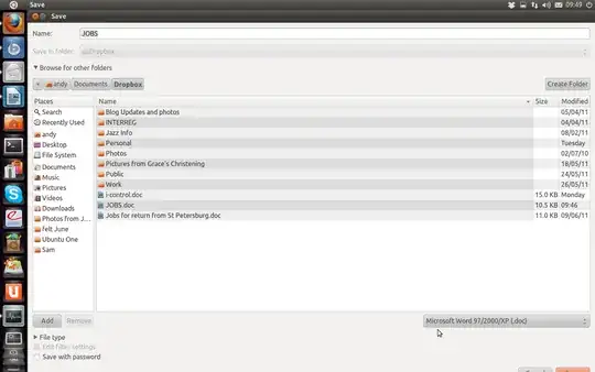

Both programmes can open Microsoft .doc files automatically .
In libreoffice and open office you will need to remember to save your documents as Microsoft xp .doc.
To do this when you want to save your document click file>save as or instead press ctrl-shift-s to save as and select microsoft word 97/2000/xp on the right hand side (see my picture here)
How to save as Microsoft files
Alternatively I have set up libre office to do this automatically as all my work has to be microsoft compatible.
If you would like to set this option up. Here is how to:
In libre-writer click tools>options>load/save>general
The select always save as Microssoft 97/2000/XP
Untick the option to warn when not saving as ODF
Press ok
Like this
Now all your documents will be saved in this format automatically
Hope that helps

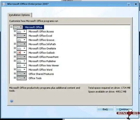

If you don't wish to use LibreOffice or OpenOffice, you can also install Microsoft Office via Wine or through PlayOnLinux.
Word, Excel and Power Point are known applications that will work and this way you can gain access to your files using these programs. There are known issues that won't allow other programs (such as Access) to work properly both in Wine or PlayOnLinux.
There are several versions of MS Office that are known to work without a hassle using PlayOnLinux and/or Wine.
Information on how to install these applications in PlayOnLinux and or Wine can be gathered on the net, examples are provided as follows:
PlayOnLinux:
http://www.wine-reviews.net/wine-reviews/playonlinux/install-ms-office2007-on-ubuntu-using-playonlinux.html
Office 2007 Installed in Ubuntu Screenshot: enter image description here
Wine:
http://appdb.winehq.org/appview.php?appId=31
Office 2007 Installer: enter image description here
Good luck!
