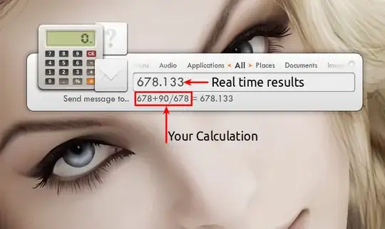

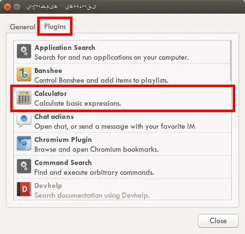

I would recommend/install synapse.
Ubuntu 12.04 and below: sudo apt-get install synapse
Ubuntu 14.04: Is synapse application launcher available?
Launch synapse by searching for it in the dash and go to the preferences menu. You can use the synapse indicator to access the preferences.
Once the window opens up, click the plugins tab and enable the Calculator plugin.
See below:
Once done, anytime you launch synapse using Ctrl + Space you can just start typing your calculation and the results will be displayed in realtime.
See below:
