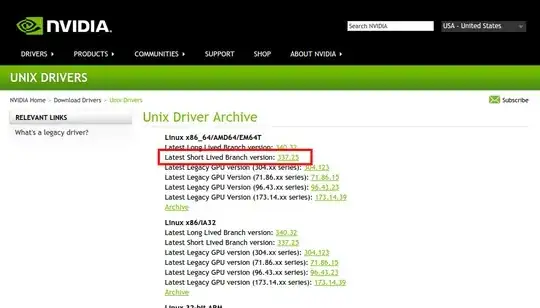

If the drivers available through Ubuntu don't work correctly, you could try finding your driver on Nvidia's official Unix/Linux driver's page. enter image description here
