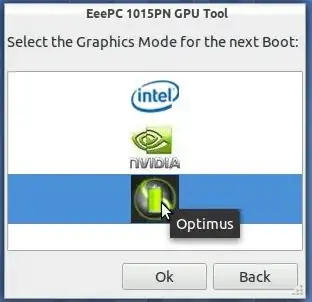

Start the 'VGA-Selector' gui and set the VGA Mode for the next boot to "Optimus"

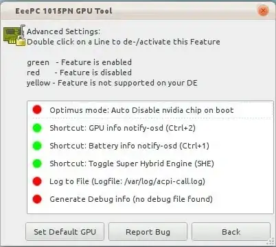

To use Optimus as default GPU mode, click on the 'Set Default GPU' button in the Settings Window. Also disable the auto-power down of the nvidia chip in optimus mode. The 'bbswitch' daemon shipped with bumblebee takes control over the power state of the nvidia gpu.
Screenshot 2
Now reboot and your laptop should be in Optimus mode.
