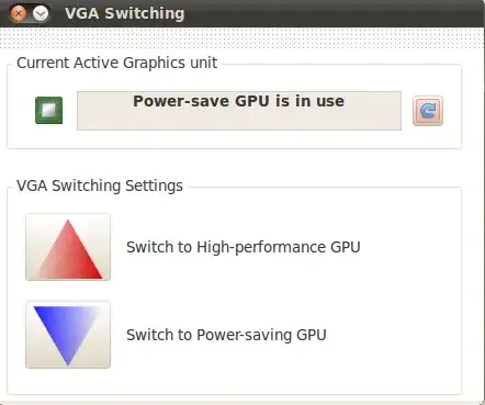

Ubuntu Control Center (UCC) is an unofficial application inspired by Mandriva Control Center, designed to bring simplicity and a less cluttered interface (because a lot of applications add themselves to the GNOME Control Center automatically) to manage the Ubuntu system settings for the simple user.
Besides being an application you can use to launch various system settings, UCC also lets you switch between low and high performance graphics cards (if you have a netbook with 2 GPUs)
