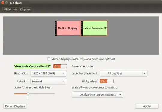

So I checked my Ssytem Settings > Displays. And it properly displays 2 screeens as seen below.

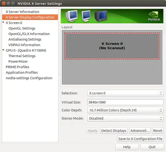

But then I went to Nvidia X Server settings & it displays just one screen with one big screen resolution as seen below.
I think this is causing my laptop to have sluggish performance because I am assuming that botht the external monitor & my laptop screen have a different screen refresh rate.

From https://devtalk.nvidia.com/default/topic/807239/nvidia-server-setting-utility-doesn-t-see-laptop-screen/ : Just be sure not to have any /etc/X11/xorg.conf* files. Run this:
sudo rm -v /etc/X11/xorg.conf*
Then rebooted again and I could log in having nvidia driver perfectly working.
