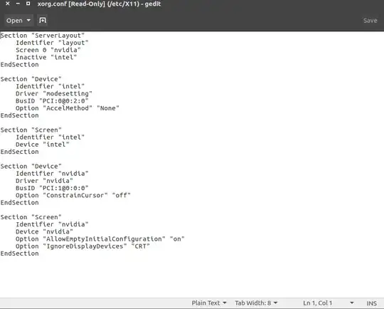

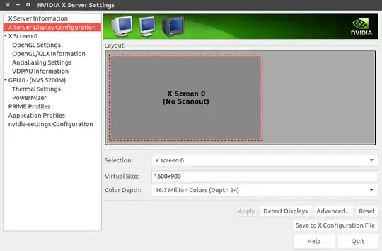

I am currently using Ubuntu 16.04. My laptop's GPU: NVIDIA NVS 5200 m (and the Intel one).I installed NVIDIA Driver version: 340.96 through
sudo ubuntu-drivers devices | grep recommended
(the same one I find in the "additional driver" setting menu recommended by Ubuntu).
The installation was fine. But when I open NVIDIA X Server Setting. It seems the driver can't detect my laptop display (also my second Dell U2414 monitor). Under the "X server Display Configuration" tab, it is shown as “X Screen 0 (No Scanout). I've attached the screenshots below. and also the xorg.conf file content.
So how can I solve this problem? Thank you all in advance!
