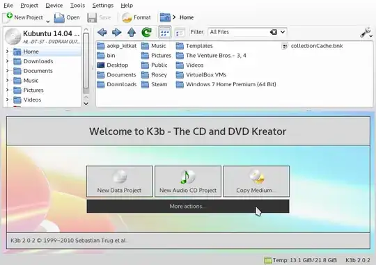

You said you have K3b. That will burn DVDs, so you may wish to use that. Burning an Ubuntu ISO image with K3b is covered in the Burning from Kubuntu section of "BurningIsoHowto" in the Ubuntu help wiki.
  1. Insert a blank CD [or DVD] into your burner. Open K3b from the KickOff menu.
  2. On the near bottom of the application where it says "Welcome to K3b - The CD and DVD Kreator" click "more actions..." and then pick "Burn Image".
  3. Start the burning process.
  4. You can use the default settings.
  5. After burning completed, verify that your CD contains multiple files and folders and not just the ISO file. This way you will know the process was performed correctly.
