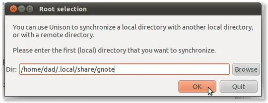

enter the FULL path to your gnote folder as per this picture

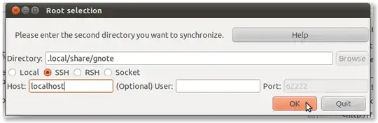

Now enter both the NAT pc gnote folder and the socket number 62222
Then click the SSH radiobutton and enter the host name localhost

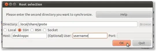

To do the same from the NAT pc start unison-gtk, configure the local gnote folder as above, and the desktop pc folder as per this picture
