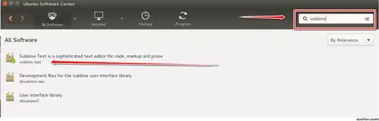

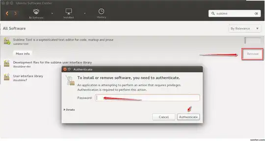

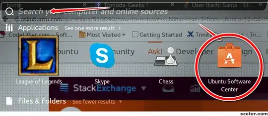

  1. Search for Software Center in the Dash.
  2. In the Software Center search for sublime, then click on "Sublime Text".
  3. Click on "Remove" then enter your password and click "Authenticate".
