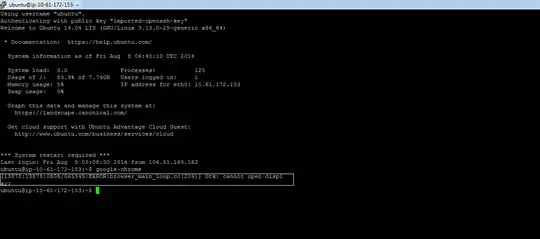

When try to open Google Chrome from command line ($ google-chrome), I am getting following error:
[5426:5426:0808/041800:ERROR:browser_main_loop.cc(209)] Gtk: cannot open display:

If you are using PuTTY on Windows (which now appears to be the case, based on the screenshot you've uploaded), then this is still an SSH connection, but you're not using the ssh command so the above client-side syntax won't help you.
