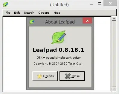

Connect to the server as you normally would. Now when you run an X11 application (such as Firefox) it will use your local X11 server:
