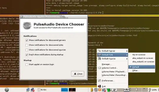

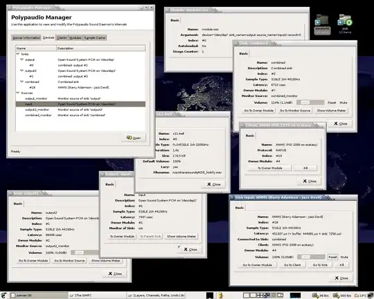

PulseAudio libraries
If someone need to handle PA adequately seems to Windows controls they can try their programming skills to maintain their own GUI library to routing PulseAudio. I think it is a rare people.
Though some chances to satisfy some needs always exist. Lookalike padevchooser or paman and other libraries for PA handling by Lennart Poettering:
PulseAudio Device Chooser 0.9.3 PulseAudio Device Chooser 0.9.3
PulseAudio Manager 0.9.4 PulseAudio Manager 0.9.4
Shortly the PulseAudio is a deep integrated audio server and the way how the users will be route their workarounds still leave is a most important task of sound programmer.

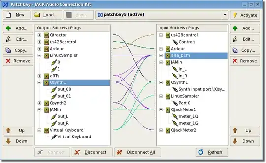

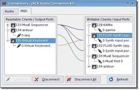

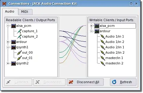

JACK libraries
Though exists absolutely different for PA solution despite the many words against this method — it is a JACK integrated to PA libraries.
Lookalike QjackCtl JACK Audio Connection Kit - Qt GUI Interface:
Main window Audio (JACK) connections window MIDI (ALSA) connections window Patchbay definition profile editor window
