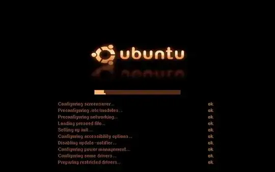

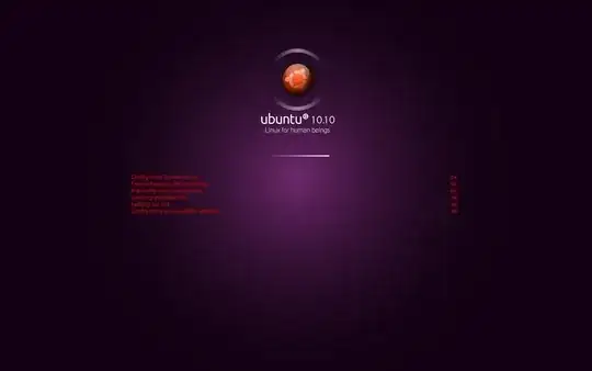

I would like to know how to create a splash for Ubuntu Maverick with boot messages being displayed when I boot as well as a progress bar and a spinning logo.
Or, if possible, how to edit a splash which already has a spinning logo and a progress bar, and add boot messages to it.
This is the theme I would like to edit:
and I would like something like this:
or this, which is the exact splash I want to create:

FANCYTTY= [ -e /etc/lsb-base-logging.sh ] && . /etc/lsb-base-logging.sh || true
Now after you've added that to the init-functions you have to edit your Plymouth theme mdv.script
This is my latest updated version of the script:
# INT2MIL-Ubuntu-10.10-Eng splashy like theme
Window.GetMaxWidth = fun (){ i = 0; width = 0; while (Window.GetWidth(i)){ width = Math.Max(width, Window.GetWidth(i)); i++; } return width; };
Window.GetMaxHeight = fun (){ i = 0; height = 0; while (Window.GetHeight(i)){ height = Math.Max(height, Window.GetHeight(i)); i++; } return height; }; #change animcount to increase/decrease speed of spinning arrows anim.imagecount = 100; anim.target_width = 0.2* 0.46 * Window.GetWidth(); anim.target_height = 0.2* 0.46 * Window.GetWidth();
fun RotatedImage (index){ index = Math.Int(index); if (!RotatedImageCache[index]) RotatedImageCache[index] = anim.original_image.Rotate((Math.Pi2index)/anim.imagecount).Scale(anim.target_width, anim.target_height);
return RotatedImageCache[index];
if (Plymouth.GetMode() == "suspend" || Plymouth.GetMode() == "resume") { background.original_image = ImageNew("suspend.png"); Window.SetBackgroundTopColor(1, 0, 0); Window.SetBackgroundBottomColor(0, 1, 0); } else { logo.original_image = ImageNew("logo.png"); background.original_image = ImageNew("background.png"); Window.SetBackgroundTopColor(0.234, 0.43, 0.705); Window.SetBackgroundBottomColor(0.16, 0.25, 0.44);
anim.image= ImageNew("animation.png"); anim.original_image= anim.image.Scale(anim.target_width, anim.target_width);
anim.sprite = SpriteNew(); anim.sprite.SetImage(RotatedImage (0)); anim.sprite.SetX((Window.GetX() + Window.GetWidth() - RotatedImage(0).GetWidth()) / 2); anim.sprite.SetY(Window.GetY() + Window.GetHeight() * 0.37); anim.angle = 0; anim.index = 0;
} #change reduction size to make logo bigger ratio = logo.original_image.GetWidth() / logo.original_image.GetHeight(); reduction = 0.4; logo.image = logo.original_image.Scale(reduction * Window.GetMaxWidth() , reduction / ratio * Window.GetMaxWidth()); logo.sprite = SpriteNew(); logo.sprite.SetImage(logo.image); logo.opacity_angle = 0; #change logo location logo.sprite.SetX((Window.GetX() + Window.GetMaxWidth() - logo.image.GetWidth()) / 2); logo.sprite.SetY(Window.GetY() + Window.GetHeight() * 0.37); #background image attributs x,z,y background.image = background.original_image.Scale(Window.GetMaxWidth() , Window.GetMaxHeight()); background.sprite = SpriteNew(); background.sprite.SetImage(background.image); background.sprite.SetPosition(Window.GetX(), Window.GetY(), -100);
sprite_prompt = SpriteNew();
fun refresh_callback () { if (status == "normal") { #anim.index=speed of rotation anim.index += 1; anim.index %= anim.imagecount; anim.sprite.SetImage(RotatedImage (anim.index)); #anim.sprite.SetOpacity (1); motif.sprite.SetOpacity(motif.opacity); } else { anim.sprite.SetOpacity(1); motif.sprite.SetOpacity(1); }
if (Plymouth.GetMode() != "suspend" && Plymouth.GetMode() != "resume") { Plymouth.SetRefreshFunction (refresh_callback); }
#----------------------------------------- Dialog --------------------------------
status = "normal";
fun dialog_setup() { local.box; local.lock; local.entry; local.prompt_sprite;
box.image = ImageNew(&quot;box.png&quot;);
lock.image = ImageNew(&quot;lock.png&quot;);
entry.image = ImageNew(&quot;entry.png&quot;);
box.sprite = SpriteNew();
box.sprite.SetImage(box.image);
box.x = Window.GetX() + Window.GetWidth()  / 2 - box.image.GetWidth()/2;
box.y = Window.GetY() + Window.GetHeight() / 2 - box.image.GetHeight()/2;
box.z = 10000;
box.sprite.SetPosition(box.x, box.y, box.z);
lock.sprite = SpriteNew();
lock.sprite.SetImage(lock.image);
lock.x = box.x + box.image.GetWidth()/2 - (lock.image.GetWidth() + entry.image.GetWidth()) / 2;
lock.y = box.y + box.image.GetHeight()/2 - lock.image.GetHeight()/2;
lock.z = box.z + 1;
lock.sprite.SetPosition(lock.x, lock.y, lock.z);
entry.sprite = SpriteNew();
entry.sprite.SetImage(entry.image);
entry.x = lock.x + lock.image.GetWidth();
entry.y = box.y + box.image.GetHeight()/2 - entry.image.GetHeight()/2;
entry.z = box.z + 1;
entry.sprite.SetPosition(entry.x, entry.y, entry.z);
prompt_sprite = SpriteNew();
prompt_sprite.SetPosition(box.x, box.y - 20, box.z);
global.dialog.box = box;
global.dialog.lock = lock;
global.dialog.entry = entry;
global.dialog.bullet_image = ImageNew(&quot;bullet.png&quot;);
global.dialog.prompt_sprite = prompt_sprite;
dialog_opacity (1);
fun dialog_opacity(opacity) { dialog.box.sprite.SetOpacity(opacity); dialog.lock.sprite.SetOpacity(opacity); dialog.entry.sprite.SetOpacity(opacity); dialog.prompt_sprite.SetOpacity(opacity); for (index = 0; dialog.bullet[index]; index++) { dialog.bullet[index].sprite.SetOpacity(opacity); } }
fun display_normal_callback () { global.status = "normal"; if (global.dialog) dialog_opacity (0); }
fun display_password_callback (prompt, bullets) { global.status = "password"; if (!global.dialog) dialog_setup(); else dialog_opacity(1); motif.sprite.SetOpacity(1); anim.sprite.SetOpacity(1);
dialog.prompt_sprite.SetImage(Image.Text(prompt, 1.0, 1.0, 1.0));
for (index = 0; dialog.bullet[index] || index &lt; bullets; index++)
    if (!dialog.bullet[index])
        dialog.bullet[index].sprite = SpriteNew();
        dialog.bullet[index].sprite.SetImage(dialog.bullet_image);
        dialog.bullet[index].x = dialog.entry.x + index * dialog.bullet_image.GetWidth();
        dialog.bullet[index].y = dialog.entry.y + dialog.entry.image.GetHeight() / 2 - dialog.bullet_image.GetHeight() / 2;
        dialog.bullet[index].z = dialog.entry.z + 1;
        dialog.bullet[index].sprite.SetPosition(dialog.bullet[index].x, dialog.bullet[index].y, dialog.bullet[index].z);
    if (index &lt; bullets)
      dialog.bullet[index].sprite.SetOpacity(1);
    else
      dialog.bullet[index].sprite.SetOpacity(0);
fun display_message_callback (prompt) {
prompt = Image.Text(prompt,1.0, 1.0, 1.0); sprite_prompt.SetImage(prompt); sprite_prompt.SetPosition(Window.GetX() + (Window.GetWidth() - prompt.GetWidth()) / 2, Window.GetY() + Window.GetHeight() * 0.93, 2); }
/* instantiate dialog at startup, to ensure all icons are loaded in memory before initrd is unmounted, in case /usr isn't mounted yet */ dialog_setup(); dialog_opacity(0); Plymouth.SetDisplayNormalFunction(display_normal_callback); Plymouth.SetDisplayPasswordFunction(display_password_callback); Plymouth.SetMessageFunction(display_message_callback);
#----------------------------------------- Progress Bar --------------------------------
progress_box.image = Image("progress_box.png"); progress_box.sprite = Sprite(progress_box.image);
progress_box.x = Window.GetX() + Window.GetWidth() / 2 - progress_box.image.GetWidth() / 2; progress_box.y = Window.GetY() + Window.GetHeight() * 0.65 - progress_box.image.GetHeight() / 2; progress_box.sprite.SetPosition(progress_box.x, progress_box.y, 0);
progress_bar.original_image = Image("progress_bar.png"); progress_bar.sprite = Sprite();
progress_bar.x = Window.GetX() + Window.GetWidth() / 2 - progress_bar.original_image.GetWidth() / 2; progress_bar.y = Window.GetY() + Window.GetHeight() * 0.65 - progress_box.image.GetHeight() / 2 + (progress_box.image.GetHeight() - progress_bar.original_image.GetHeight()) / 2; progress_bar.sprite.SetPosition(progress_bar.x, progress_bar.y, 1);
fun progress_callback (duration, progress) { if (progress_bar.image.GetWidth () != Math.Int (progress_bar.original_image.GetWidth () * progress)) {
* 3 = multiply progress by 3
    progress_bar.image = progress_bar.original_image.Scale(progress_bar.original_image.GetWidth(progress_bar.original_image) * progress * 3, progress_bar.original_image.GetHeight());
    progress_bar.sprite.SetImage (progress_bar.image);
Plymouth.SetBootProgressFunction(progress_callback);
#----------------------------------------- Status Update --------------------------------
NUM_SCROLL_LINES=10; LINE_WIDTH=55;
width of one character doesnt work------------
CHAR_WIDTH = 7;
height of one character
CHAR_HEIGHT = 10; #------------------------
msg_color = [1,1,1]; # msg_color is array
#status callback function
fun update_status_callback(sta) { if (sta == "failed") msg_color = [1,0,0]; if (sta == "warning") msg_color = [0.8,0.8,0]; if (sta == "normal") msg_color = [0.5,0.5,0.5]; }
screen_width = Window.GetWidth(); screen_height = Window.GetHeight();
#Initialising text images and their positions
20 is the height (including line spacing) of each line
for (i=0; i < NUM_SCROLL_LINES; i++) { lines[i]= Image.Text("", msg_color[0], msg_color[1], msg_color[2]); message_sprite[i] = Sprite(); message_sprite[i].SetPosition(screen_width * 0.025, (screen_height * 0.6) + (i * 20), 10000); }
fun StringLength(string) {
index = 0; str = String(string); while(str.CharAt(index)) index++; return index; }
pretext = String("");
#scroll message function
fun scroll_message_callback(text) {
##nobreak function
nobreak = 0; if (text.CharAt(0) == ">") { # "no linebreak" flag, like "-n" text = text.SubString(1, StringLength(text)); # remove ">" at front nobreak = 1; }
if ((pretext == "") || (StringLength(text) > 15)) { if (text == ".") return; # ignore messages of only a single dot
   if (nobreak == 1) pretext = text;
#Truncate the message if too long
if (StringLength(text) > LINE_WIDTH) { text = text.SubString(0, LINE_WIDTH - 0); text += "..."; }
#Shift message one up
for (i = 0; i < NUM_SCROLL_LINES - 1; i++) { lines[i] = lines[i+1]; }
} else { # the previous message was flagged to have no linebreak
      // Truncate the message if too long
   if (StringLength(text) &gt; LINE_WIDTH - 5) { # leave min. 5 for pretext
     text = text.SubString(0, LINE_WIDTH - 8);
     text += &quot;...&quot;;
      # Truncate the previous message if too long
   if (StringLength(pretext) &gt; (LINE_WIDTH - StringLength(text))) {
     pretext = pretext.SubString(0, LINE_WIDTH - StringLength(text) - 3);
     pretext += &quot;...&quot;;
   text = pretext + text;
   else pretext = &quot;&gt;&quot;;
#Create the image for the latest message
 lines[i] = Image.Text(text, msg_color[0], msg_color[1], msg_color[2]);
#Re-positioning the text images
for (i = 0; i < NUM_SCROLL_LINES; i++) { message_sprite[i].SetImage(lines[i]); } }
Plymouth.SetUpdateStatusFunction(update_status_callback);
Plymouth.SetUpdateStatusFunction(scroll_message_callback);
#----------------------------------------- Quit --------------------------------
fun quit_callback () { anim.sprite.SetOpacity (1); if (Plymouth.GetMode() == "shutdown") { motif.sprite.SetOpacity(1); } }
Plymouth.SetQuitFunction(quit_callback);
Basically the script can be applied to any theme, all you have to do is provide the filenames of the images in the folder. And changing a few other lines to adjust the images on the screen. Or what you do is you copy the necessary part like the lets say you want the progress part so all you have to do is copy everything from
till
After you are done with editing the mdv.script be sure to sudo update-initramfs -u and on your next boot you shall see your new splash.
Be sure to check out the links provided in my question they are very informative and will get you to understand plymouth scripting in no time.
Now if you have done everything i said here you boot splash should display scrolling messages. Now about the truncating part, I am currently working on it, but its kinda annoying to have to reboot my machine everytime i make some change. Is it possible to test a boot process while am logged in like
sudo plymouthd ; sudo plymouth --show-splash ; sudo plymouth update --status="Hello" ; sleep 2 ; sudo plymouth update --status="This is a test. This is a test. This is a test. This is a test. This is a test. This is a test. " ; sleep 10 ; sudo killall plymouthd
Another way you can test Plymouth is by copying the above command into a text file and adding sudo plymouth update --status="your message" to have more messages scroll through. Then make the file executable and run in terminal.
Hope this helps anyone else wanting to edit their Plymouth splash. Good Luck!!!
