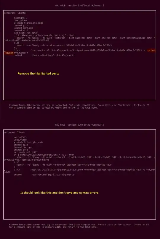

Temporarily disable splash
You can edit the boot entries in the menu from within GRUB to temporarily disable the splash screen.
Try the following: Select the entry, press the key to edit this entry (it should be e), go to the kernel/linux line and remove quiet splash, then press F10 to boot.
Here are two screenshots from a VM to show you how it should look like:
Permanently disable splash
The permanent equivalent was already quoted in Riccardo Murri's answer:
  1. Remove splash from the kernel command-line. You can do this per-boot, or make it permanent by changing the GRUB_CMDLINE_LINUX_DEFAULT line in /etc/default/grub.
... followed by update-grub as superuser.
