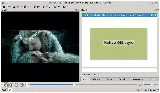

QtCurve
The latest QtCurve /1, 2/ has widget style for applications based on the Qt 5.x.
The QMPlay2 (Qt5) /3/ with the native Qt5 and the QtCurve widget styles:
