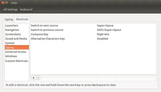

I find I can do the correct accents quite simply using the compose key.
The grave à is achieved by pressing (in my case) the Right Windows key RtWinthena then the `¬| key in succesion (top left of keyboard next to the 1! key) and not necessarily together, just one after the other.
The other accents are just as logical. The least obvious is ç which is RtWin key then c then comma ,.
I hope that helps and that I have understood your requirement properly.
