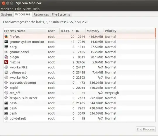

According to the Processes tab of the system monitor they're running:

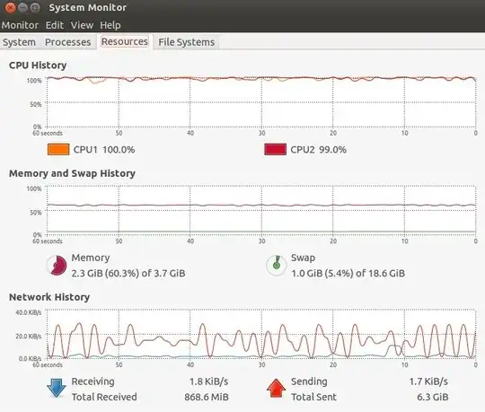

And according to the Resources tab of the same system monitor they're running:
I never installed compiz, which is what most of the other people asking this question were pointed at as the culprit (e.g. here), and compiz doesn't show up in my processes list, so I don't think the issue is there (unless it's hidden from me for some reason). Any ideas as to why there is a discrepancy and how I can figure out just how much work I'm putting the old machine through?
The snapshots that these tools give you are useful when you are monitoring them, but really you need something that tracks over a little more time. They are only taking time slices and will report spikes in applications (such as THEMSELVES) which are red herrings.
I notice you have a web server running, is the machine serving many users? Is it possible to start the machine without running any graphical programs and then just monitor 'top' via a tty (i.e. cntrl-alt-F10)? That might take the UI pieces out of the equation at least.
Alternatively you could try shutting down apache and seeing if the machine load is a little more stable.
I'd stick to 1 process monitoring tool (certainly at a time) so that you don't see them all reporting on each other.

I think that at least top and System Monitor are being consistent. Look at the load averages: they are consistently above 2, and given that you have a dual-core system, that means both of your CPU cores are being fully utilized over the past 1, 5 and 15 minutes respectively. This is also shown by the System Monitor CPU usage graph. As for the rest, the actual utilization of a CPU by a given set of processes is very, very volatile - they can differ from one instant to another unless there's something guiding the scheduler, like a hungry process with a high nice value.
